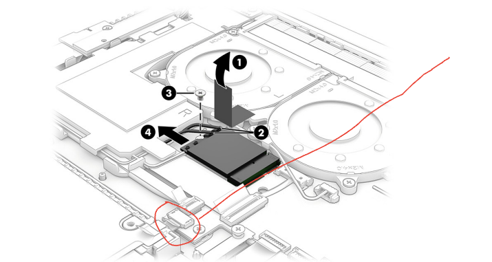

To answer your question. It is not really clear in the service manual as the beginning says it supports it, But, then the section to replace the hard drive is missing. In the pictures, we can see it is present.
page 38 missing hard drive section.
https://h10032.www1.hp.com/ctg/Manual/c07070931.pdf
so you will need to check if the slot that accepts the flex cable is present on the motherboard

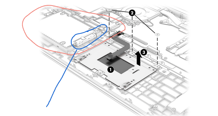

here you can see how the hard drive is placed
If the slot on the motherboard is present, you will need to purchase the cable (blue in the picture above). The manual does not offer a part number for the cable.
Personally, I would try this cable.
Hard drive connector/cable     L52656-001
Example
https://www.amazon.com/CSEZWASM-17M-CE0013DX-L52656-001-L54516-001-450-0G809-0001/dp/B0B976R6YM
So, if you have the cable then you can insert a HDD (max 2TB because of thickness of drive)
or a 2,5" SSD (no limit to capacity)
