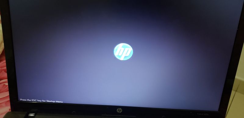

I did change the battery because none of the methods you mentioned worked with me, fortunately the "hp battery alert" didn't show again but the problem is that the laptop won't start up
First the screen will be like thisFirst the screen will be like this
Then it will turn to black like this, after that it will go back as the first image and so onThen it will turn to black like this, after that it will go back as the first image and so on
I'm a student and my laptop is so important because it has all my projects and such things so I hope that there is a quick solution that won't let me lose my files.
Immediately after powering on start tapping the Esc key. This will open a menu where F2 System Diagnostics is an option. Tap F2 key and run the tests. If you don't have F2 option use F10 to enter BIOS and look for Diagnostics in there. Looks like you may have a hard drive problem.

@CherylG I tried this several times. The diagnostic starts well but then the laptop will suddenly shut down some people told me that I should reset it to factory settings but there are some important files that I don't want to lose so is there any other options? Or can I at least get back those important files?
I don't think you can reset it to factory settings if you  upgraded to Windows 10. You have Win 10 listed as current OS in your first post and that is not what it shipped with. Of course you could still try it but usually upgrading to Win 10 corrupts the Recovery partition. Unless of course you have Recovery Media?
Actually, I am afraid the laptop would shut down trying to reset to factory also. Probably the best thing to do before tring anything else is recovering your files. Remove the hard drive, hook it to a USB HDD Adapter and plug it into usb port of a working computer. If the drive is ok you should be able to browse it for files and copy them over to drive of host machine.
