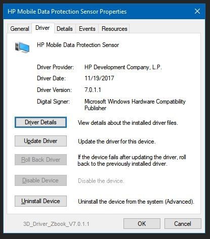

I do not use the HPSA on my Zbook;  I can only guess why the HPSA is tripping over the update / version.
In fact, though, Zbook has a newer 3D Guard Driver installed than is suggested in the SDM (Softpaq Download Manager - used on business class computers and workstations).
Looking at Windows Updates shows that the driver was updated in Windows Update on May 10, 2018.  The version is 7.0.1.1.
3D_Driver_Zbook_V7.0.1.1_WU3D_Driver_Zbook_V7.0.1.1_WU
Oddly, Windows Update does not know the actual name of the driver and installed it as "HP Developement Company, L.P."
The install details all match and checking the Event Viewer verifies that the driver was indeed updated on the given date.
3D_Driver_Zbook_V7.0.1.13D_Driver_Zbook_V7.0.1.1
In SDM and on the Zbook Software and Driver Support page, the older 6.0.45.1RevA is still listed as the "current" driver "sp84595".
At least in the case of the SDM software, it is smart enough to know the 3D software does not need an update -- my guess is that it can detect the installed version.
Conclusion
HPSA is ignorant of what is installed, either because the driver was installed by Windows Update AND / OR because the name of the installation is "wrong", the HPSA cannot see the installed version correctly.
Ignore the HPSA update - mark it as ignored or trash it as settings in the HPSA allow.

However, I seem to have version 7.0.2.1 installed - is this incorrect?
Conclusion
