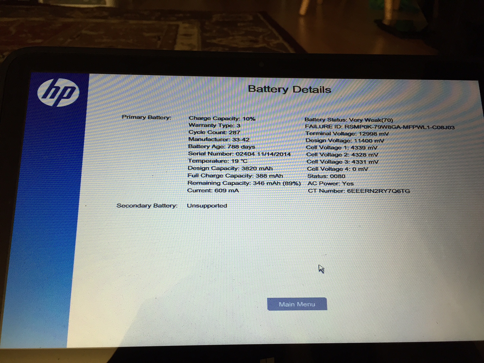

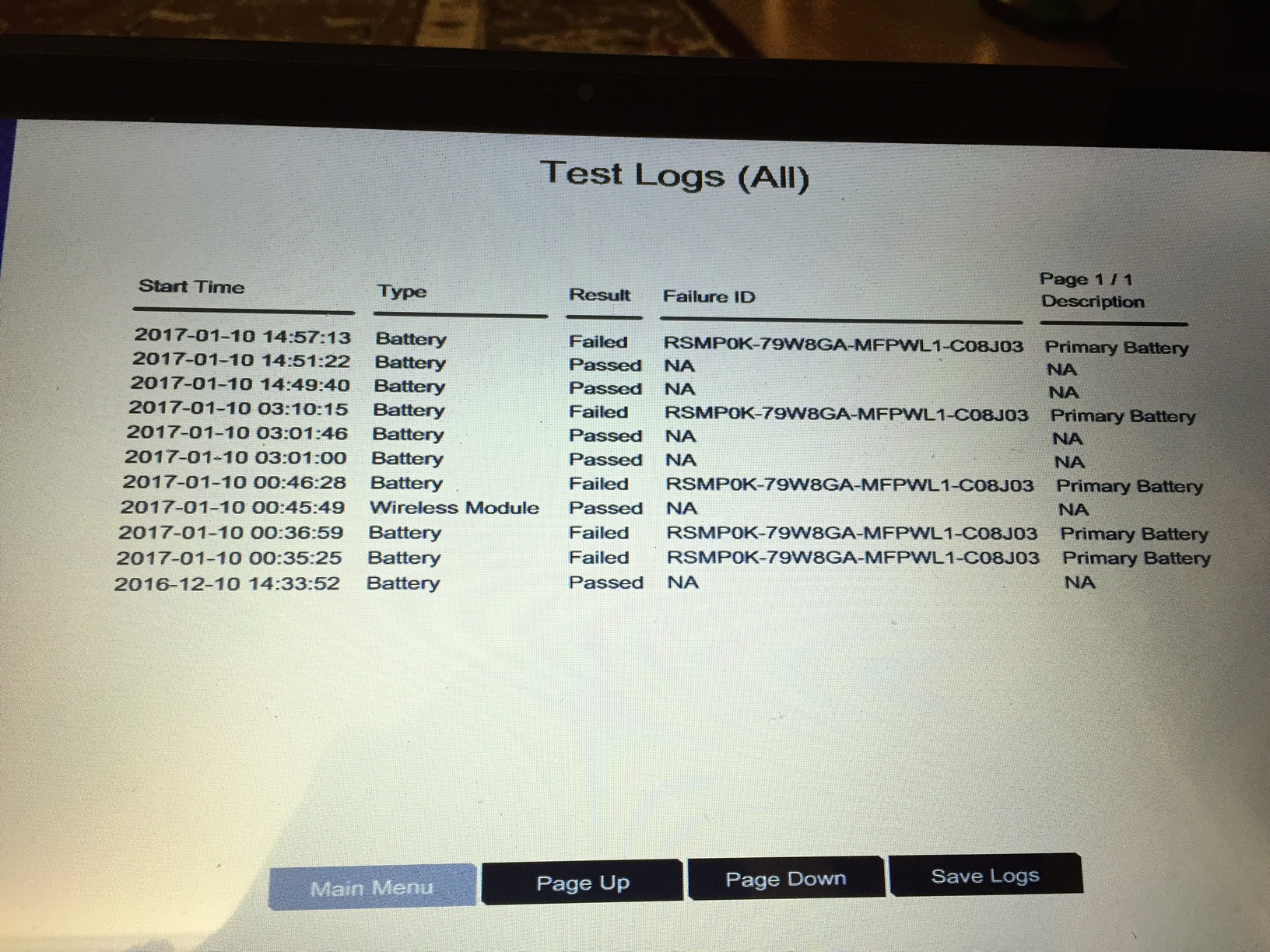

After trying all the suggested recommendations I still have not resolved my issue.  I have however, tried the F2 startup menu numerous times to run a battery diagnostic and it tells me that the battery is fine one time, then it is very weak the next time.  I have attatched three pictures to show you what I mean as well as a test log.  The first photo tells me that the battery is very weak, the second shows me that it passes, and the third photo is a test log to show the inconsistencies in tests.   I think these photos will show you / give you a better idea of what is going on.
Thanks,
Nick
