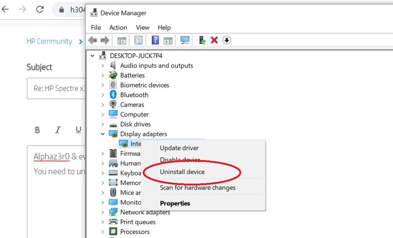

Alphaz3r0 & everyone, I found the solution. And it works wonderfully !
You just need to uninstall device driver of the display Adapter in device manager.
And it gets automatically solved.
There is no need for second monitor anymore,
finally the expensive laptop is now worth the money.

I've uninstalled the display driver, reboot, then windows will automatically reinstall the driver again.
Name of driver seems to be the same, but it does seem the screen look more solid now.  The sure view button still works too.
When set to max brightness, the screen seems a bit 'less bright' then before, but other than that everything seems to work fine.
I was going to suggest you to install the driver after after you uninstall it from the device manager.
I guess if you restart the laptop, the system will pick up the missing driver automatically too.
So its same thing.
I agree, the screen ( on correct driver ) is less bright than the wrong driver, but the screen is much more view-able.
The colors are "almost" correct compared to disastrously wrong color before which pains the eye after just 10 mins of viewing.
btw, you can try to fix further you can setup the color profile under "Color management" Setting.
Add a new color profile there. I dont know how exactly color profile work, but i think we can look it up on google and try fix the color setting here once the correct driver is installed.
