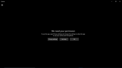

Dear Customer Care,

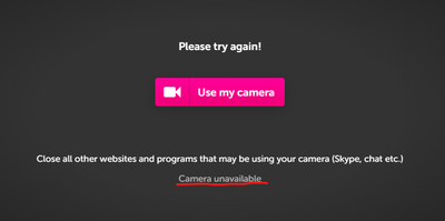

My Inbuilt Camera in the laptop has suddenly stopped working, due to so-called 'Privacy Settings'. However, all my Camera Settings are enabled, allowing all my apps access to my Camera. I've tried updating the drivers, or even reinstalling the camera using Device Manager, but to no avail. The Camera does not work in the Camera App, nor in Google Meet, nor in Zoom. Basically, it does not work anywhere. Any possible fixes for this, please?
And also everywhere else where the camera is supposed to work, it does not.
Thanks for reading my issue, and hope you can fix it as soon as possible as it is affecting me pretty hard 😞

Thanks a lot @KrazyToad ! I used the HPSA to download certain updates, and now, my camera is working perfectly 🙂
Also, please note that I had to reinstall my Antivirus (K7 Computing), as it seemed to be blocking access for my cam. So, if anyone of you has this issue and has an antivirus installed, please try changing it's settings/permissions or reinstall it if you have to.
