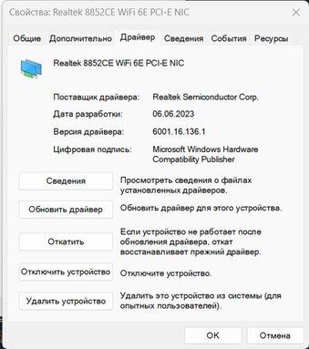

Almost clean laptop and I noticed the problem.
Almost every 30 seconds (it may be more, it may be less) there are friezes on the WiFi 5Ghz network. I've tried everything - reset the network settings, update different versions of drivers, remove the device and reinstall it, but no results. Just at a random moment, packet loss occurs and that's it.
What should I do about it?
Device and driver version:
