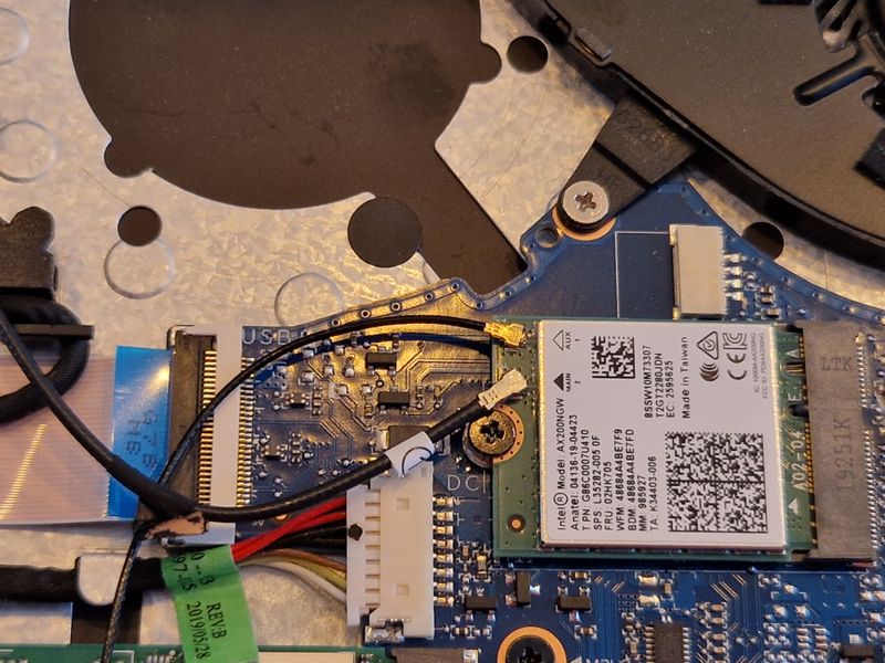

I bought a second antenna for Bluetooth and were able to but it at that place were the HDD normaly is mounted. I have a SSD, so there was a good place. See the pictures.
The only thing: The speed is not much better 😂  Maybe the original Antenna is not a good one? In wifi6 with 5 Ghz i get appr. 100Mbit/s download speed. Very close ti the router. With my mobile phone: 950Mbit/s.  Maybe i buy a other good Antenna to try.
The Bluetooth is working very well. I only need it for my Mouse.
