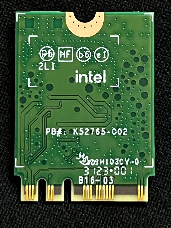

I want to replace this piece of garbage card with an Intel card.  I bought a reputable AX210NGW card.  The card is hard blocked.  There is NO hardware switch for WiFi on this model.  It is not soft blocked.  I have read that pin #20 is probably to blame.  You can see that there are two pins on the front at E on the AX210NGW that are not there on the RTL8822CE.  I assume they are the culprits.  But I am NOT going to do surgery with a piece of tape to make it work.  I even reinstalled Linux.  I tried several distros:  Kubuntu, Pop!OS, Fedora 39, I even tried GhostBSD.  Nothing works.  So, I'm sending it back.  I downloaded the ucode driver from Intel's web site and installed it, still no go.
AX210NGW

Thank you very much for your suggestion.  I noticed that there are pins on the front of the E section of the AX200 card, just as there were on the AX210 card.  Are these the pins that are causing the "hard block" error?  The RTL8822CE card does not have them.  From what I read, it might be that pin #20 is sending a signal that the computer is registering as a physical disconnect (like a WiFi on/off switch).
What exactly is different between the AX210 and AX200?  The pin arrangement seems the same between them.  And they are both different than the RTL8822CE.

Looking at an illustration of the AX201 there is no 'A' section of the card, and the 'E' section has quite a few pins.
