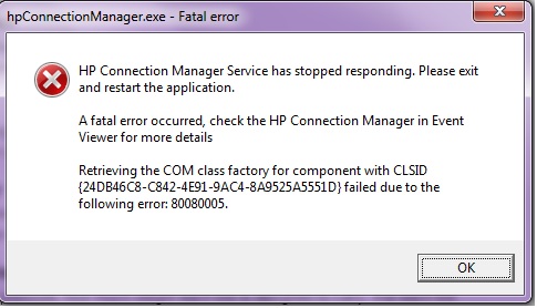

I've got a really big problem with HP Connection Manager 4 on several Windows 7 notebooks. The program is installed on about 250 notebooks and some of them just drive me crazy. Everything was fine until at some point (I’m not quite sure, it could be after installing Win7 SP1), the Connection Manager decided to stop working on some machines. Whenever I try to start it, it takes a long time to load until the following error message occurs:
"HPConnectionManager.exe - Fatal error
HP Connection Manager Service has stopped responding. Please exit and restart the application.
A Fatal error occurred, check the HP Connection Manager in Event Viewer  for more details.
Retrieving the COM class factor for component  with CLSID {24DB46C8-C842-4E91-9AC4-8A9525A5551D} failed due to the following error 80080005."
I’ve tried the following on one of these notebooks:
-          Starting the service manually: “Error 1067: The process terminated unexpectedly.”
-          Msconfig: Removed everything Connection Manager related from autostart
-          Reinstalling HP Connection Manager
-          Repairing HP Connection Manager
-          Reinstalling .NET 3.5
-          Changing some regkeys
-          Installing Microsoft Hotfix KB2519740 which is part of the Essential System Updates for Microsoft Windows 7 (which I can’t download because there’s a server error)
Some more information:
-          (mostly) HP Probook 6550b
-          Windows 7 Enterprise 64 Bit, SP1 (English, German MUI)
-          HP Connection Manager 4.1.22.1
The only thing that really works is to reinstall the notebook with the image with which we install all of them. The HP Connection Manager is installed as a software package afterwards so I don’t get it why a reinstallation is successful.
I’m really tired of this problem and I’ve got some unhappy customers on my back so if you’ve got any suggestions for me, please help.
Thanks in advance!

Thanks for your reply!
The Probook 6550b is not listed as supported model at this page:  ftp://ftp.hp.com/pub/softpaq/sp58501-59000/sp58930.html
Do you think it will work anyway?
Depends..
The "uncertainty" factor is the reason I suggested that you experiment with a single system prior to trying to migrate this sort of change.
I do not believe that the Connection Manager has the same level of machine sensitivity exhibited by the device drivers.
Dragon-Fur
YAY! It's working now after installing the new version! Thank you so much! :OpenSmile:

I've got an issue with HP Connection Manager on my main Windows 7 notebook. This is the error I get (attached)
HP Connection Manager Fatal Error.jpg:
Retrieving the COM class factor for component  with CLSID {24DB46C8-C842-4E91-9AC4-8A9525A5551D} failed due to the following error: 80080005."
Some information:
-          HP Pavilion dv7-6123cl Entertainment Notebook PC, model dv4t - 1300
-          Product number: NJ924AV
-          Windows 7 Home Premium 64 Bit, SP1
Thanks in advance!
