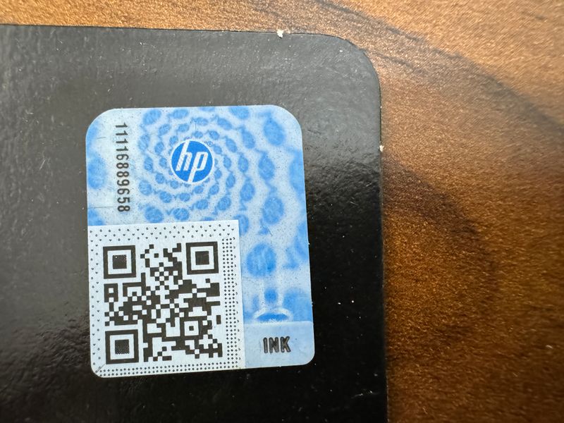

I have tried following the instructions & did some more research online as well. I even bought the set of new cartridges & replaced.
the error message says cartridge M is depleted.
at times it shows all cartridges level full a time half but when the printer starts the initialization finally the message shows cartridge depleted. IMG_8215.JPGIMG_8227.JPGIMG_8226.JPGIMG_8222.JPGIMG_8225.JPG
I just bought the new one, & it has ink, but the printer keeps sending this massage.
kindly share your thoughts.
