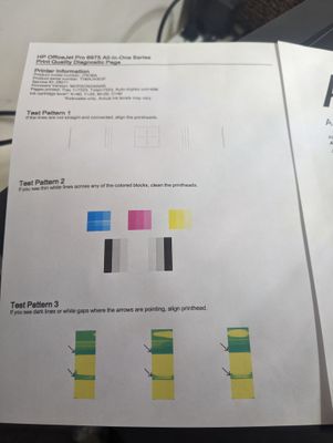

Have followed your directions and directions in the link twice if I hadn't already tried them in previous attempts(the main steps described below I repeated regardless of previous days attempts). 1st pic is quality print report immediately after cartridge removal and shutdown. 2nd pic is after a cleaning. 3rd is after 2nd tier cleaning. 4th pic is after 3rd tier cleaning. Last photo is after a 3rd cartridge removal and shut down.

Two new cartridges and still this same result. Spotty blue, if any at all.
Riddle me this: I ran out of Y. Did a quality after days of not printing. That page is on the left. I immediately replace the Y and print the page on the right? What? What? What is up?
