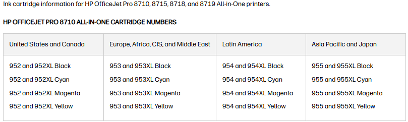

I see HP 952 cartridges are compatible with your printer if your printer is bought and used in United States and Canada only.
If not HP 952 is not compatble with your printer.
Let me share the cartridge compatible table.
If your are using the compatible cartridge, then share the error message that you are getting for further assistance.
