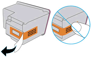

CAUTION: Do not touch the copper-colored contacts or the ink nozzles, or reapply the protective tape. Touching these areas can result in an ink system failure.
  • Holding the cartridge by its sides, remove the plastic tape using the pull tab.
Removing the plastic tape from the ink cartridge
