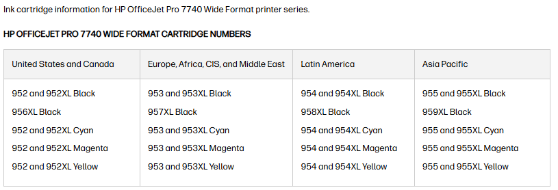

Because the cartridges are region-specific, find below the table attached:
Your printer will accept 952 cartridges only if they were setup and used in the USA or Canada.
If you are using the correct region cartridges, then try the below suggestions:
