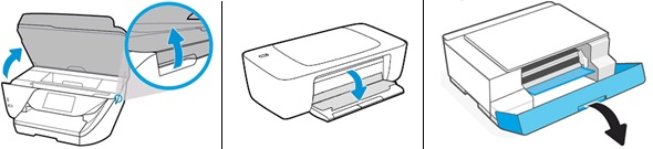

  • Open the door to access the carriage inside of the printer.
Examples of carriage access doors
Examples of printer door locations

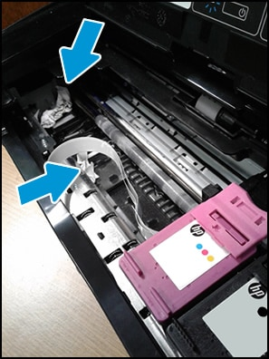

  • Look in the carriage path for debris such as crumpled paper or dislodged labels, and then remove any that you find.
Example of a printer with debris in the carriage path
View inside a printer showing crumpled paper in the carriage path causing a carriage jam

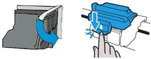

  • If the carriage on your printer has a latch, make sure it is closed.
Example of the carriage latches
