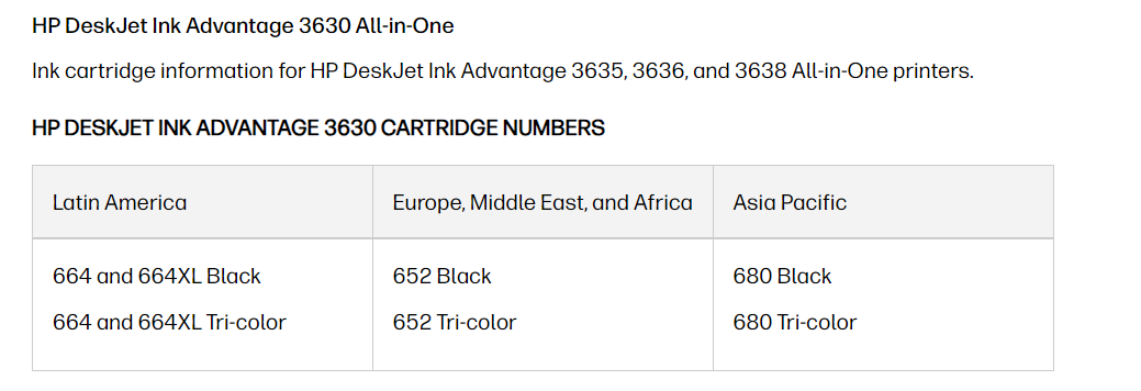

Please check the below screenshot for the cartridge details for your region
