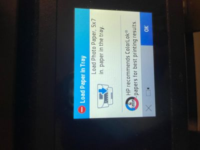

My printer recognizes that there is 5x7” specialty paper in the main tray and so does my Hp Smart app  but when I send my print job it always fails and then my printer tells me to load 5x7” photo paper in the tray.
I cannot try the photo tray at all because my cardstock is just slightly over 5” wide so it does not fit in the tray.
Can anybody help me?
