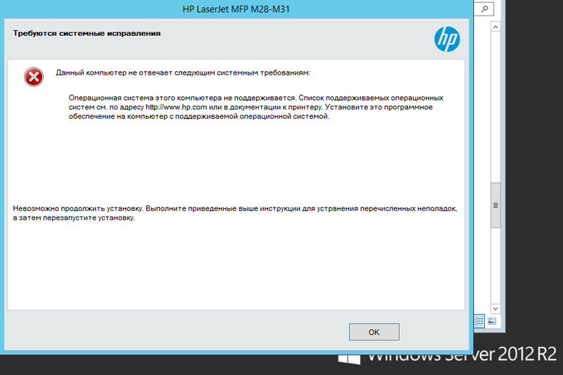

I want to install a scan drivers on server for scaning by network.
I have an operating system Windows Server 2012 R2 Standart (russian).
I downloaded a driver.  (https://support.hp.com/us-en/drivers/selfservice/hp-laserjet-pro-mfp-m28-m31-printer-series/16647082...) by choosing "Windows Server 2012 R2"
 I'm connecting to the server by RDP and traing to install the driver. On "step 3" i have a message, it says "The Operating system of this computer is not supported. ...".
How can it be?

2019/03/27 17:16:57 [11632] {tid: 0x1EB0} (M1) Done Displaying screen: 4, returning 1
2019/03/27 17:16:57 [11632] {tid: 0x1EB0} (M1) CDeviceSetupUI::Display, Displaying "DeviceSetup Connection Type screen"
2019/03/27 17:17:05 [11632] {tid: 0x1EB0} (M1) Done Displaying "DeviceSetup Connection Type screen", returning "Invalid Display Response"
2019/03/27 17:17:05 [11632] {tid: 0x1EB0} (M1) User chose to connect device later
2019/03/27 17:17:05 [11632] {tid: 0x1EB0} (M1) CFinishSetupUI::DisplayModeless, Displaying "FinishSetup: Modeless status screen"
2019/03/27 17:17:05 [11632] {tid: 0x1EB0} (M1) Displaying "FinishSetup: Modeless status screen" as modeless
2019/03/27 17:17:05 [11632] {tid: 0x1EB0} (M1) CFinishSetupUI::Display, Displaying "FinishSetup: No Device Connected screen"
2019/03/27 17:17:06 [11632] {tid: 0x1EB0} (M1) Done Displaying "FinishSetup: No Device Connected screen", returning "UserOK"
2019/03/27 17:17:06 [11632] {tid: 0x1EB0} (##) DeviceSetupBusinessLogic::Run returning an error: 1236
2019/03/27 17:17:06 [11632] {tid: 0x1EB0} (WN) Failed to get DeviceSetupFinished event handle. Error: 2
2019/03/27 17:17:06 [11632] {tid: 0x1EB0} (##) DeviceSetup Main failed with 1236
