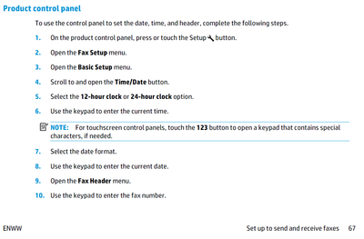

Hi,
did you set the time and date with it
Regards
Andr-1611
I'm not an employee of HP, I'm as volunteer here.
Inquiries via private messages (PM) cannot be answered.
Yes, I have accessed the mentioned control panel and procedures via the soft display at (too) many times in the way described by you above, this due to the fact that date/time resets each time when I have shut off the equipment.
