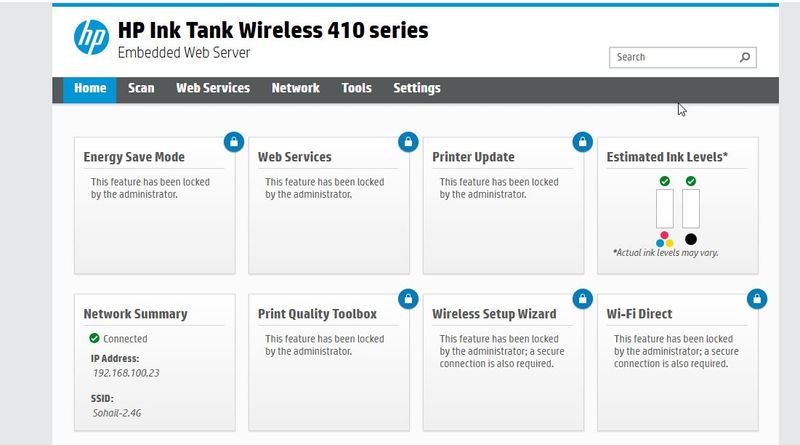

I forget the password, i try to reset but all available method on internet are not working. please help me. thanks
1 REPLY 1
Watch the reset video. After resetting, you generally have 2 hours to complete the setup. Decide if you want to connect the printer to the router or to print directly to the printer and bypass the router.
Many HP and other OEM printers have problems with the router when the router has two bands and both bands have the same name (SSID). Log into the modem and rename one of the bands. Alternately, contact your ISP and have them rename a band.
Or simply use Wi-Fi direct.
