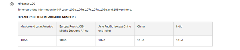

I bought a 107w printer and it worked fine with the default toner cartridge (107A).
I did not find 107A cartridges here and bought 106A (which is officially compatible), but it does not work due to the "Invalid toner" error (error C2-1510)
It turned out that the printer was from Singapore. I suspect that the new toner is not working due to the region, so help me with replacing it (I have seen several answers with a similar problem here)
Thanks for the help!
09-29-2024 01:07 PM - edited 09-29-2024 01:11 PM
You are correct. the 106A would be correct if your printer had originally shipped with it but the 107A is Asia Pacific. I have tagged your post with the moderators as there are no do it yourself region change instructions I can find and may require intervention, if possible at all.
