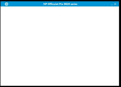

I download the software and tried to install hp drivers as administrator. The program launches correctly but about one minute later the program freeze with blanc screen (see image). I waited about 15 mn without any good result 😞 I really don't industand what happen.
My antivirus is disable when I trie to install the program.
Please do you have any idea ?

There is some type of corruption.  An install should not freeze.  If you have not run the system file checker then be sure to do it now.  .
