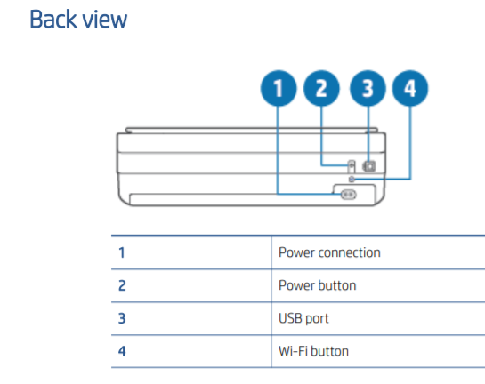

Please follow the steps listed below to restore the printer to its network defaults and then reconnect it to the network:
Step 1: Restore the printer to its network defaults.
On the back of the printer, press and hold the Wireless button for 5 seconds. This will put the printer is in the Auto Wireless Connect (AWC) setup mode.
When the printer is in the AWC setup mode, the Edge lighting will glow purple, pulsing from the middle outward, repeating.
A picture containing table
Description automatically generated
