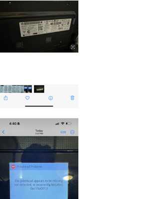

the printer head appears to be missing . not detected or incorrectly installed Ox19a0013 error message

I see that you are facing an issue with your Printer that has printhead error.
A) Please follow the steps below to perform a power drain.
1) Take out the cartridges
2) Unplug the power cord from the printer & wall.
3) Press and hold the power button down for 15 seconds and release the power button, wait for about 30 seconds.
4) Plug the power cord back into the printer and wall, ensure the printer is plugged into the wall & not into a surge protector.
5) Insert the cartridges back into the printer.
Remove the cartridges > Unplug the power cord > Wait for 30 seconds > Plug the power cord back in > Insert the cartridges
B) Kindly refer to the steps on this link to update the printer firmware and let me know if that resolves the issue.
C) Refer to the steps on this link to further troubleshoot.
D) If the issue still persists, refer to the steps on this link to restore factory defaults and let me know if that resolves the issue.
