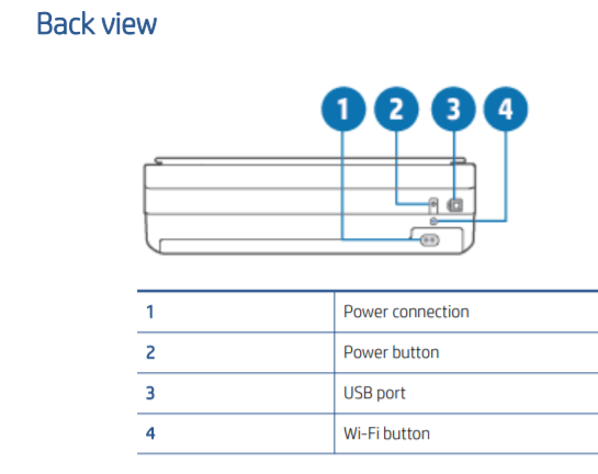

I have the Envy 6000 series. I've unplugged the devices per instructions but my printer still shows offline. I ran the support doctor and still cannot use my printer. The Wifi button will not stay engaged and I can't seem to find a live person to chat or talk to about this. Please help...

On the back of the printer, press and hold the Wireless button for 5 seconds. This will put the printer is in the Auto Wireless Connect (AWC) setup mode.
When the printer is in the AWC setup mode, the Edge lighting will glow purple, pulsing from the middle outward, repeating.

Hi @Ladair,
I see that you are facing printing issues with your HP Envy 6000 All-In-One Printer.
Please follow the steps listed below to restore the printer to its network defaults and then reconnect it to the network:
Step 1: Restore the printer to its network defaults.
