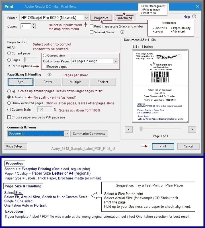

Example - Avery 5912 - PDF - Label Print (Reader DC - Windows)
Avery_5912_Sample_Label_PDF_Print_6Avery_5912_Sample_Label_PDF_Print_6
