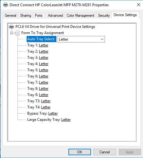

Here is the way this printer's driver page appears:
If I switch the driver to a Universal Print Driver PCL 6, the properties change to this...
Please advise.   Is there a way to disable these notifications directly from the printer control panel on one of the other HP Printer Applications (Such as HP Smart)?

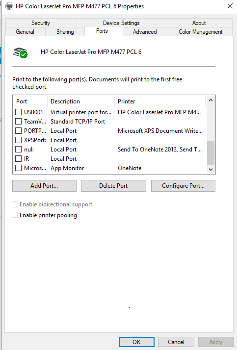

hi i have tried this but the bidirection support box is not checked.this is the screen shotthis is the screen shotsee th attached photo
please assist
please assist
