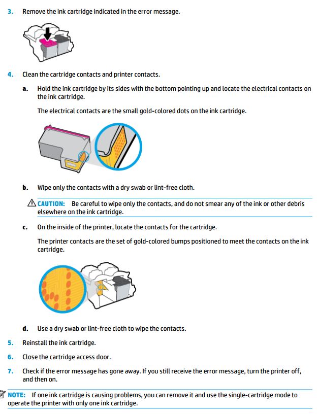

Now, please clean the cartridges manually as described below:
NOTE: Do not touch the ink nozzles.
I sincerely hope this fixes the issue. Keep me posted. Cheers! 🙂
