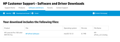

Now I find time to figure it out. I follow steps and when I delete my printer and I tried to instaled I have window, that this sowtware is not actuall, but I installed software from official page and it is the same
Zrzut ekranu 2017-03-17 o 21.34.34.pngZrzut ekranu 2017-03-17 o 21.34.34.pngZrzut ekranu 2017-03-17 o 21.34.49.png
