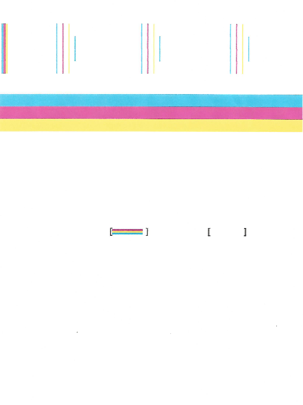

I have had this same issue. When I print the quality diagnostics page i get this: scan.png
No black ink what-so-ever. I went through the troubleshooting list (http://support.hp.com/us-en/product/HP-Deskjet-2540-All-in-One-Printer-series/5295960/model/5295961/... and i'm now at the point where I need to have the printer serviced. As I've tried to figure this issue out I'm seeing that I'm far from the first person who has had this issue with this printer. Is there something wrong with this model as a whole? am I missing something else I can try?
