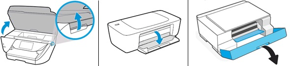

  • Open the door to access the carriage inside of the printer.
Examples of carriage access doors
Examples of printer door locations

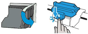

  • If the carriage on your printer has a latch, make sure it is closed.
Example of the carriage latches
