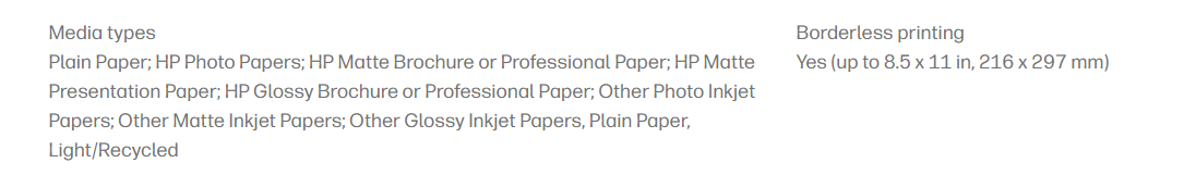

1. Check Paper Compatibility HP ENVY Photo 7830 All-in-One PrinterProduct specifications
Ensure the glossy paper you are using is compatible with your printer. Refer to the printer's user manual or the HP website for recommended paper types and weights.
