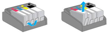

  • Push in the tab on a cartridge, and then lift it out of the slot.
Removing the cartridge from the carriage
  • Reinsert the cartridge into its color-coded slot, and then press down on it until it snaps into place.
