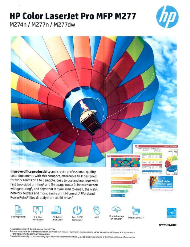

Both my ADF and flatbed scanner on the M277DW leave two strange embossed lines on the scan output file. Before you ask, the the glass on the ADF area and the flatbed is scrupulously clean. And the originals are undamaged by the scan process. Here's the scanned image below with the mysterious scan artifacts.
I've added green arrows to the highlight where the "embossed" line is. The lines are not part of the original image.
From the flatbed scanner:
From the ADF:

Do you see any debris on the underside of the glass or on the scanner head? I am not convinced of that as the defect appears to move around. While a pain, in some cases, performing a factory reset (which will require you to setup the printer again) will resolve random issues like this.
