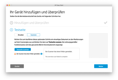

Now when I'm trying to scan with Apples Image Capture App I can choose the scanner/printer but get the following error:
HP Easy Scan just freezes while preparing the scan:

HP Easy in the most recent version reports the following error while trying to test the scanner:
