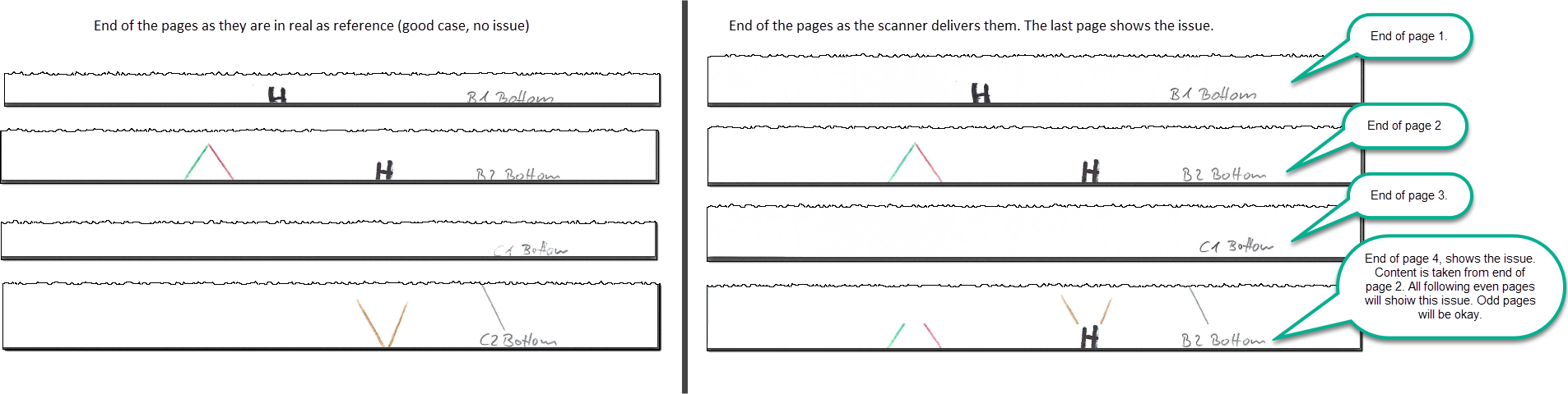

Here is an example of what this problem looks like:
(see also here for a better background when viewing this image)
On the left side you see the content of the pages as it is in reality (two papers => four pages), on the right  side you see the scan result with the issue on the last page. For clarity, only the end of the pages is shown.
