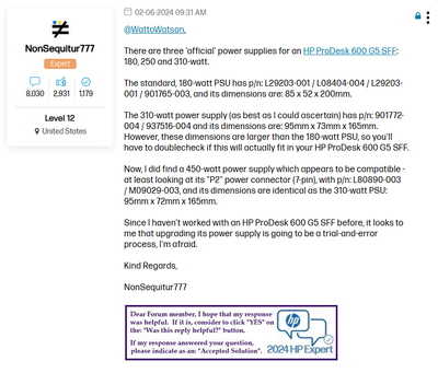

However, in a related discussion:
I speculated that a 450-watt power supply (p/n: L80890-003) with these dimensions: 95mm x 72mm x 165mm may be (notice added emphasis) compatible, but it is unclear to me if this power supply will physically fit inside your case.  If I had an HP ProDesk 600 G4 SFF, I would try it, and if it didn't work out (trial and error), I would return it to Seller to get my money back.
