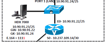

Our company buy a polycom VBP 5300-E, I installed that VBP on our central office and connect its wan interface with Internet and lan interface with our lan, Our central office are connected with  some branch offices through MPLS. Every office has a HDX system. I configure that VBP as a embbered  gatekeeper, When i call from internet to our offices by dialling “VBP Public IP ## E.164”, call establish successfully. But when i call from intranet to internet (say Polycom test ip), call cannot establish.  Please give me a solution.

can u tell me; what will be the gatway of Site A HDX 7000, ?
The document states the GW would be10.90.91.22:

but, when i want to make a call form Inside to outside, how packet move into the internet world,  if the defalt gateway is 10.90.91.22
The video call would exit the network to the Public thru Port 2 (WAN) port (200.x.x.x. in the diagram)..

I think you are trying to make this too hard...
Your VBP is basically, a Video Firewall.   It KNOWS how to handle H.323 traffic and update all the packets correctly (H.225, H.245, etc)...
Your HDX will "register" to the embedded Gatekeeper of the VBP.   You should also point the HDX's IP Default Gateway to the LAN side of the VPB (10.x in this example).
The VBP will have a LAN side that is 10.x and in this example, 210.x.x on the public internet...
At this point, you should be able to call from the HDX on the LAN side to anywhere on the public that has H.323 capability.
