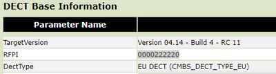

This would be a very odd question and Polycom support basically gave up and told me to return the D230 base. The D230 base was pre-programmed by Centurylink and we are in the midst of changing from Centurylink hosted voip to Zoom voip service. We took two different D230 pre-programmed with Centurylink firmware upgrade URLs and attempted to provision them for Zoom. Unbeknownst to me was the Centurylink firmware URL, therefore, I plugged it into a POE port, without the base provisioned in Centurylink. Once that happened, the D230 base's DECT region changed over to "EU DECT (CMBS_DECT_TYPE_EU)". I have had no way to revering it, even by doing hard resets from the pin hole in the back, or downgrading the firmware then re-upgrading the firmware using Zoom's firmware URL. Before this all happened, I knew for sure the base was in the US DECT region and I was able to pair handsets against this base.
Polycom support does not have a solution for me but saying that the base is from Europe even though it's packaged in a "NA" (north america) box, which doesn't make sense to me whatsoever. Because the base was in the US DECT region until it somehow flipped. My attempt to use different firmwares yesterday even ended up with the TAIWAN DECT at one point using v7.0.2 firmware.

I still have the two D230 units with me that changed the DECT region to EU and I see no way of modifying that.

06-28-2022 07:49 AM
I finally got a closure to this issue. Polycom development was able to come up with a fix-up firmware for me to upgrade to, which took about 3 weeks to make and test. After I "upgrade" to that firmware, the D230 base reverted back to the US DECT region, then I was able to upgrade the firmware once more with the provider specific firmware. Lastly, I was able to pair the US DECT handsets to the base.

I have this same issue. I believe it has some connection to the latest firmware 7.1.2, and the option where it deletes the eeprom.
After I did that, my VVXD230 that I bought in North America now claims the EU DECT version, and just like yours the handsets won't register.
