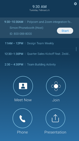

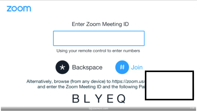

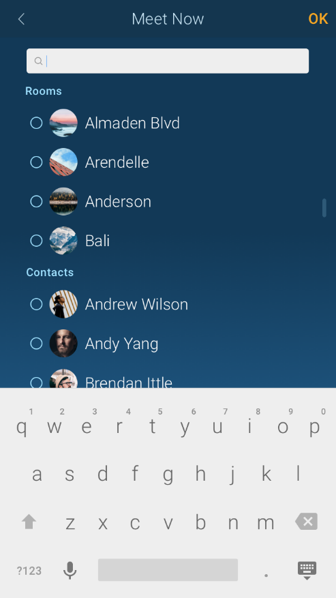

Since Trio UC Software 5.7.1 Poly now supports the Zoom Rooms Control (ZRC) application running natively on the Polycom Trio
NOTE: The Poly C60 is not yet certified to be used by Zoom Rooms!
To enable connect the Trio via a USB Cable to a Zoom Room PC or Mac:
In-Meeting:
Join Scheduled Meeting
Meet Now
Join with Meeting ID
For more details or official Support please check => here <= and/or work with Zoom support directly

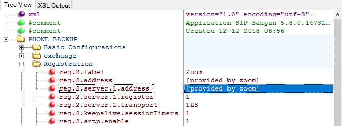

Since UC Software 5.5.2 the Polycom Trio supports hybrid registration. This enables the Poly Trio to register natively to a Skype for Business server or an openSIP server on line 1 but offers to set also a Zoom registration to Line 2.
Simply download the attached files => here <= and unzip these.
Then simply import the one suiting your setup via your Web Interface as shown => here <=.
This will create a 2nd (or 3rd or 4th) Line and pressing this line will automatically dial into a Zoom conference.
