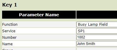

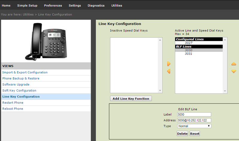

Or Utilities > Line Key Configuration (Depending on the phone model supporting this!):

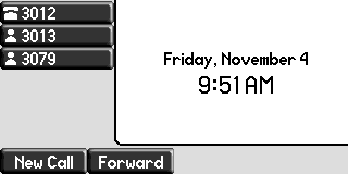

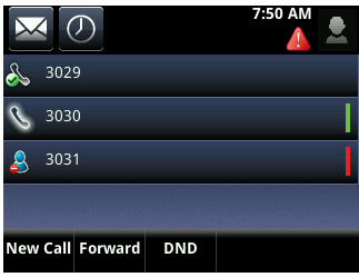

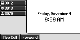

MONITORING PHONES
Once the Phone has booted the idle screen shows the monitored Extensions:
image image

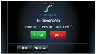

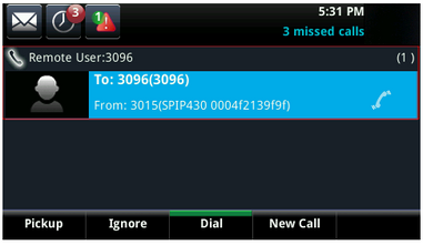

An Incoming Call with details is presented like this:
on the VVX after a few rings the screen returns to this:
or
<normal attendant.behaviors.display.spontaneousCallAppearances.normal="0"/>
The above actually stops the phone pop up and simply displays below view.

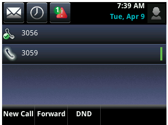

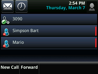

The Busy State of a monitored Phone is presented like this:
image image
Pressing the relevant monitored Line will show the call details in a scrolling window:
An additional 2nd call to a monitored extension is displayed via a green flashing LED (LED actually flashes green):

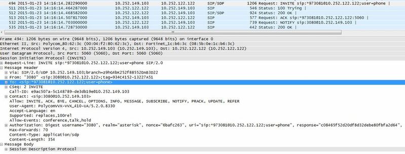

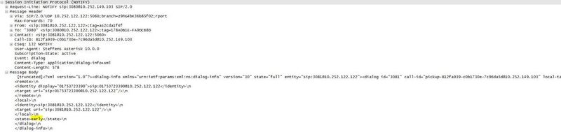

Wireshark trace:
Subscribe
Notify (alerting)
SIP at Debug:
0123142658|sip  |0|00|<<<Data Received UDP
0123142658|sip  |0|00|    NOTIFY sip:[email protected] SIP/2.0
0123142658|sip  |0|00|    Via: SIP/2.0/UDP 10.252.122.122:5060;branch=z9hG4bK4ecf9148;rport
0123142658|sip  |0|00|    Max-Forwards: 70
0123142658|sip  |0|00|    From: <sip:[email protected]>;tag=as5c89ccfe
0123142658|sip  |0|00|    To: "3080" <sip:[email protected]>;tag=BC6E7859-A9523F8E
0123142658|sip  |0|00|    Contact: <sip:[email protected]:5060>
0123142658|sip  |0|00|    Call-ID: [email protected]
0123142658|sip  |0|00|    CSeq: 337 NOTIFY
0123142658|sip  |0|00|    User-Agent: Steffens Asterisk 10.0.0
0123142658|sip  |0|00|    Subscription-State: active
0123142658|sip  |0|00|    Event: dialog
0123142658|sip  |0|00|    Content-Type: application/dialog-info+xml
0123142658|sip  |0|00|    Content-Length: 583
0123142658|sip  |0|00|    <?xml version="1.0"?><dialog-info xmlns="urn:ietf:params:xml:ns:dialog-info" version="235" state="full" entity="sip:[email protected]"><dialog id="3081" call-id="[email protected]" local-tag="BC6E7859-A9523F8E" remote-tag="as5c89ccfe" direction="recipient">
<remote>
<identity display="Spectralink 8030 00907a07c46c">sip:[email protected]</identity>
<target uri="sip:[email protected]"/>
</remote>
<local>
<identity>sip:[email protected]</identity>
<target uri="sip:308
0123142658|sip  |0|00|    [email protected]"/>
</local>
<state>early</state>
</dialog>
</dialog-info>

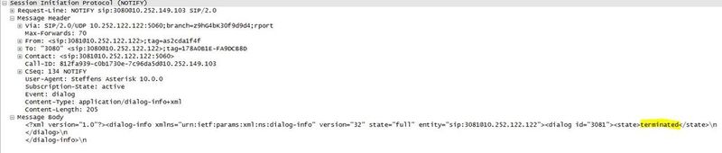

Notify (Busy state / answered call)
SIP at Debug:
0123142804|sip  |0|00|<<<Data Received UDP
0123142804|sip  |0|00|    NOTIFY sip:[email protected] SIP/2.0
0123142804|sip  |0|00|    Via: SIP/2.0/UDP 10.252.122.122:5060;branch=z9hG4bK789e4a71;rport
0123142804|sip  |0|00|    Max-Forwards: 70
0123142804|sip  |0|00|    From: <sip:[email protected]>;tag=as5c89ccfe
0123142804|sip  |0|00|    To: "3080" <sip:[email protected]>;tag=BC6E7859-A9523F8E
0123142804|sip  |0|00|    Contact: <sip:[email protected]:5060>
0123142804|sip  |0|00|    Call-ID: [email protected]
0123142804|sip  |0|00|    CSeq: 341 NOTIFY
0123142804|sip  |0|00|    User-Agent: Steffens Asterisk 10.0.0
0123142804|sip  |0|00|    Subscription-State: active
0123142804|sip  |0|00|    Event: dialog
0123142804|sip  |0|00|    Content-Type: application/dialog-info+xml
0123142804|sip  |0|00|    Content-Length: 205
0123142804|sip  |0|00|    <?xml version="1.0"?><dialog-info xmlns="urn:ietf:params:xml:ns:dialog-info" version="239" state="full" entity="sip:[email protected]"><dialog id="3081"><state>confirmed</state>
</dialog>
</dialog-info>
Notify (clearing call / hanging up)
SIP at Debug:
0123142917|sip  |0|00|<<<Data Received UDP
0123142917|sip  |0|00|    NOTIFY sip:[email protected] SIP/2.0
0123142917|sip  |0|00|    Via: SIP/2.0/UDP 10.252.122.122:5060;branch=z9hG4bK38447a44;rport
0123142917|sip  |0|00|    Max-Forwards: 70
0123142917|sip  |0|00|    From: <sip:[email protected]>;tag=as5c89ccfe
0123142917|sip  |0|00|    To: "3080" <sip:[email protected]>;tag=BC6E7859-A9523F8E
0123142917|sip  |0|00|    Contact: <sip:[email protected]:5060>
0123142917|sip  |0|00|    Call-ID: [email protected]
0123142917|sip  |0|00|    CSeq: 342 NOTIFY
0123142917|sip  |0|00|    User-Agent: Steffens Asterisk 10.0.0
0123142917|sip  |0|00|    Subscription-State: active
0123142917|sip  |0|00|    Event: dialog
0123142917|sip  |0|00|    Content-Type: application/dialog-info+xml
0123142917|sip  |0|00|    Content-Length: 206
0123142917|sip  |0|00|    <?xml version="1.0"?><dialog-info xmlns="urn:ietf:params:xml:ns:dialog-info" version="240" state="full" entity="sip:[email protected]"><dialog id="3081"><state>terminated</state>
</dialog>
</dialog-info>

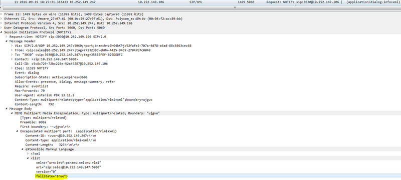

Resource List Subscriptions (RLS) RFC4662
Since UC Software 5.4.5 or later Polycom partially supports the Asterisk RLS
extensions.conf
pjsip.conf
Polycom Configuration:
<asterisk attendant.uri="[email protected]" />

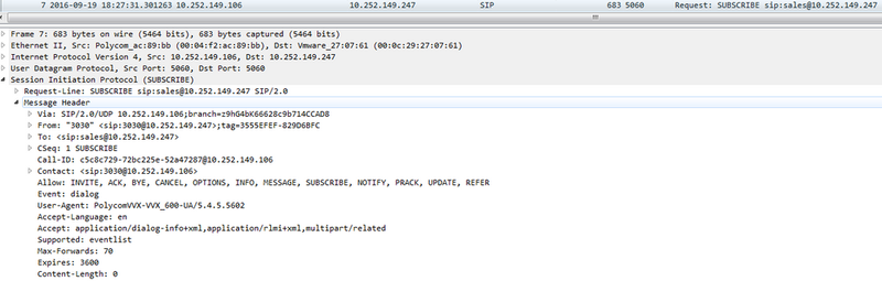

Initial SUBSCRIBE
0919182624|sip  |0|00|    SUBSCRIBE sip:[email protected] SIP/2.0
0919182624|sip  |0|00|    Via: SIP/2.0/UDP 10.252.149.106;branch=z9hG4bK44199cd8D82FDCB5
0919182624|sip  |0|00|    From: "3030" <sip:[email protected]>;tag=60F5E2C4-835810E1
0919182624|sip  |0|00|    To: <sip:[email protected]>
0919182624|sip  |0|00|    CSeq: 1 SUBSCRIBE
0919182624|sip  |0|00|    Call-ID: [email protected]
0919182624|sip  |0|00|    Contact: <sip:[email protected]>
0919182624|sip  |0|00|    Allow: INVITE, ACK, BYE, CANCEL, OPTIONS, INFO, MESSAGE, SUBSCRIBE, NOTIFY, PRACK, UPDATE, REFER
0919182624|sip  |0|00|    Event: dialog
0919182624|sip  |0|00|    User-Agent: PolycomVVX-VVX_600-UA/5.4.5.5602
0919182624|sip  |0|00|    Accept-Language: en
0919182624|sip  |0|00|    Accept: application/dialog-info+xml,application/rlmi+xml,multipart/related
0919182624|sip  |0|00|    Supported: eventlist
0919182624|sip  |0|00|    Max-Forwards: 70
0919182624|sip  |0|00|    Expires: 3600
0919182624|sip  |0|00|    Content-Length: 0
0919182624|sip  |0|00|<<< End of data send
Ringing:
0919182624|sip  |0|00|    NOTIFY sip:[email protected] SIP/2.0
0919182624|sip  |0|00|    Via: SIP/2.0/UDP 10.252.149.247:5060;rport;branch=z9hG4bKPj2a0121ec-84fa-4c6c-a780-a1874f6ef39e
0919182624|sip  |0|00|    From: <sip:[email protected]>;tag=b9c7d407-eefd-4945-b727-dd3759728dc7
0919182624|sip  |0|00|    To: "3030" <sip:[email protected]>;tag=60F5E2C4-835810E1
0919182624|sip  |0|00|    Contact: <sip:10.252.149.247:5060>
0919182624|sip  |0|00|    CSeq: 5344 NOTIFY
0919182624|sip  |0|00|    Subscription-State: active;expires=3600
0919182624|sip  |0|00|    Allow-Events: presence, dialog, message-summary, refer
0919182624|sip  |0|00|    Require: eventlist
0919182624|sip  |0|00|    User-Agent: Asterisk PBX 13.11.2
0919182624|sip  |0|00|    Content-Type: multipart/related;type="application/rlmi+xml";boundary=xdycj
0919182624|sip  |0|00|    Content-Length:   792
0919182624|sip  |0|00|    --xdycj
0919182624|sip  |0|00|    Content-ID: <[email protected]>
0919182624|sip  |0|00|    Content-Type: application/rlmi+xml
0919182624|sip  |0|00|    Content-Length:   323
0919182624|sip  |0|00|    <?xml version="1.0" encoding="UTF-8"?>
<list xmlns="urn:ietf:params:xml:ns:rlmi" uri="sip:[email protected]:5060" version="0" fullState="true">
 <name>sales</name>
 <resource uri="sip:[email protected]:5060">
  <name>3314</name>
  <instance id="zuibm" state="active" cid="[email protected]" />
 </resource>
</list>
0919182624|sip  |0|00|    Content-Type: application/dialog-info+xml
0919182624|sip  |0|00|    Content-Length:   233
<dialog-info xmlns="urn:ietf:params:xml:ns:dialog-info" version="0" state="full" entity="sip:[email protected]:5060">
 <dialog id="3314">
 </dialog>
</dialog-info>
Using Static BLF / Busy Lamp Field with a Poly VVX x50 Obi Edition or Edge B phone
Poly VVX x50 Obi Edition:
Poly Edge B:
The basics of configuring a BLF: IP Phone > Line Keys (or Left Line Keys), under the desired Key <N>
  • Function = Busy Lamp Field
  • Service = Desired SPn registration
  • Number = Number of the extension of the monitored party
  • Name = Name or identifier of the monitored party

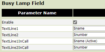

The BLF line key label can also be customized: IP Phone > Line Key Customization, under Busy Lamp Field
  • Enable = Checked
  • TextLine1 = Macro and any text for the BLF in idle state
  • TextLine2 = Macro and any text for the BLF in idle state
  • TextLine1InCall = Macro and any text for the BLF in an active state
  • TextLine2InCall = Macro and any text for the BLF in an active state
For example, the following line key customization is configured, specifically TextLine1InCall = $name (Active):
When the monitored extension is on the phone, the phone will display the line key customization text, e.g. John Smith (Active):
BLF State and Colors
  • Idle = G -> LED is solid green when no activity on BLF
  • Ringing = G500, X500 -> LED blinks green for 500 ms then off for 500 ms when BLF is ringing
  • Busy = R -> LED is solid red when on a call or calling
  • ServiceDown = O -> LED is blank when SIP server is down and registration/subscription fails

A Syslog server will display the relevant SIP messages
NOTIFY sip:[email protected]:5060 SIP/2.0
Via: SIP/2.0/UDP 172.21.177.17:5060;branch=z9hG4bK30304e23;rport
Max-Forwards: 70
From: <sip:[email protected]>;tag=as67b470ae
To: <sip:[email protected]>;tag=SP1ffb904f16c36fb52
CSeq: 115 NOTIFY
User-Agent: Steffens Asterisk 11.21.2
Event: dialog
Content-Length: 207
<dialog-info xmlns="urn:ietf:params:xml:ns:dialog-info" version="13" state="full" entity="sip:[email protected]">
<dialog id="3036">
</dialog>
</dialog-info>

Settings > Logging > Module Log Level Limits > SIP > Debug
The phone receives the NOTIFY sip: with, <state>confirmed</state> & <param pname="+sip.rendering" pvalue="no" />, and as per LED customization in phone config, the LED Indicator flashes yellow, Default behavior for BLF hold is slow flashing red.
