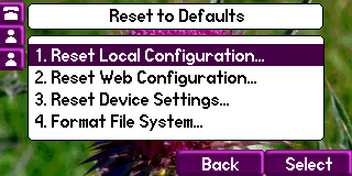

Option 2 via the Phone GUI:
The Phone GUI can be used to reset certain Sections of the Phones Configuration / Filesystem

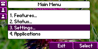

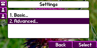

Press the Menu Key:
Select Settings

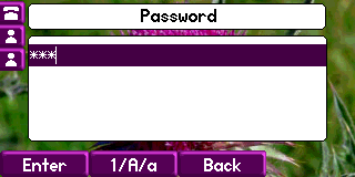

Select Advanced (Password 456)
Select Admin Settings

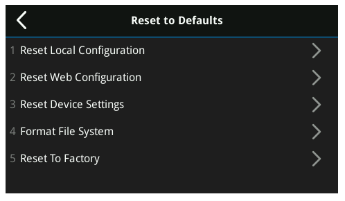

Select Reset to Defaults
Later UC Software Version
Explanation of the individual Options:

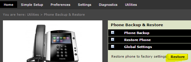

Resetting to Factory Defaults
The basic network configuration referred to in the subsequent sections can be reset to factory defaults using a menu selection from the Advanced Settings menu or using multiple key combinations described in Multiple Key Combinations.
NOTE: Above only reset's the Phones Network Settings!
Reset Local Configuration
To clear the Phones Configuration that has been changed using the Phones GUI.
Changes are usually written to the Provisioning Server as a <mac>-phone.cfg (depending on the Phone Software!)
NOTE: If there is no Provisioning Server the Phone will still hold this Information and it takes precedence over the configuration files!
Reset Web Configuration
To clear the Phones Configuration that has been changed using the Phones Web Interface.
Changes are usually written to the Provisioning Server as a <mac>-web.cfg (depending on the Phone Software!)
Reset Device Settings
The above specifically deletes all changes from the Device Setting as an example CDP/LLDP or VLAN
Anything from this section:
Format File System
To clear the phones’ memory and will require to download the Phones Software from a Provisioning Server.
Reset to Factory (Only UC Software 4.0.0 or later!)
Above clears the flash parameters and removes log files, user data, and cached data.

The above now requires the Admin password 456.
If the Admin Password is unknown please use the Mac of the Phone.
Here are the exact keystrokes to reset a phone with an example MAC Address of 00-04-F2-AA-81-4C

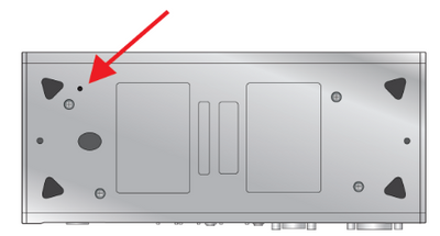

Factory Resetting of the VVX D60 / VVX D230 Base Station:
If a user would like to reset the base station, there is a reset button beside the power socket, use pin/paper clip to long press for 7 sec.

Factory Restore a Poly Trio 8800, 8500 or RealPresence Visual+
Factory restore a Poly VisualPro
  1. Power off the system.
  2. Straighten a paper clip and insert it into the pinhole.
  3. Using the paper clip, press and hold the restore button.
  4. While continuing to hold the restore button, press the power button once.
  5. Keep holding the restore button for 10 more seconds, then release it.

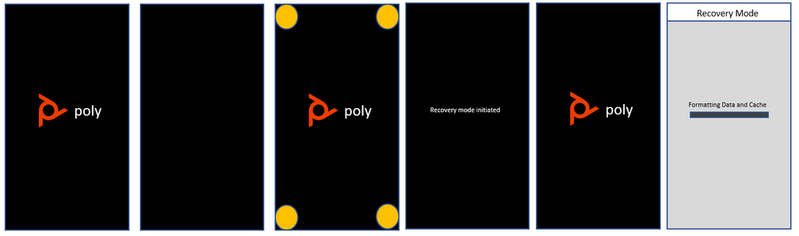

Factory restores Poly Trio C60:
  1. Power on the system.
  2. image
  3. When the Screen lights up before the Poly logo shows on the screen, press and hold the four corners of the LCD screen.
  4. Let go when the Mute keys begin flashing in different colours.

For the CCX 500 & CCX 600 & CCX 700
  1. Power up the CCX
  2. The 1st time the logo appears and then disappears
  3. Once the Logo appears the 2nd time press all 4 corners of the screen for around 2 seconds
  4. "Factory mode initiated" message will appear
  5. The unit will reboot and factory reset process will commence

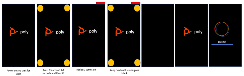

CCX400:
  • Power up the CCX400 and wait until the Poly Logo appears
  • Hold 4 fingers for 1-2 seconds and then let go
  • Once the MWI LED becomes Red hold 4 fingers again until the screen goes blank
  • Let go and a Poly Logo will appear
  • After this the Android "erasing" screen will show and the unit is reset
