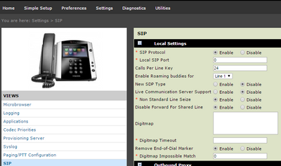

You can change content via the Phone Web Interface
SIP => Local Settings => Digit

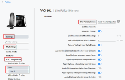

Using Poly Lens
Depending on a Phone type, per site, etc. Policy the Dial Plan can be added to Phones
  • My Settings > Call Configuration > Lines > Line X > Dial Plan > Dial Plan (Digitmap) either a Resource File containing a configuration with a Digitmap or copy and paste a digit map based on the above FAQ
