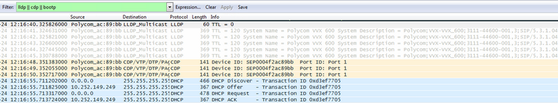

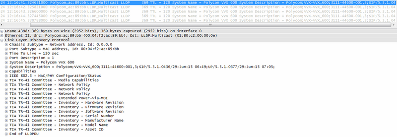

The below illustrates the initial => LLDP Discovery <=
Check Step 2 => here <= in order to disable LLDP

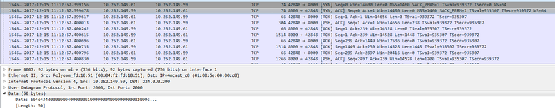

000016.816|lldp |1|00|Sending LLDP packet with length (lldpPktLen= 37)
000017.817|lldp |1|00|Sending LLDP packet with length (lldpPktLen= 369)
000018.817|lldp |1|00|Sending LLDP packet with length (lldpPktLen= 369)
000019.819|lldp |1|00|Sending LLDP packet with length (lldpPktLen= 369)
000020.820|lldp |1|00|Sending LLDP packet with length (lldpPktLen= 369)
000021.820|lldp |1|00|Sending LLDP packet with length (lldpPktLen= 369)
NOTE: Please check the UC Software Admin guide on details for configuration parameters to either disable LLDP or modify the LLDP Discovery !
Parameters to change the behaviour:
<?xml version="1.0" encoding="utf-8" standalone="yes"?>
<!-- number min 3 max 10 default  -->
<web device.set="1" device.net.lldpFastStartCount.set="1" device.net.lldpFastStartCount="10"/>
The above Parameter would send 10 LLDP packets instead of the original 5 packets
<!-- number of seconds minimum 0 maximum 3600 default 0 -->
<web net.lldp.extendedDiscovery="60"/>
The above Parameter would delay the sending if LLDP packets by 60 seconds so a switch can be ready to provision the settings to the port.
Any reply to the LLDP and we do not send CDP packets!
Followed by the => CDP <= discovery
Check Step 2 => here <= in order to disable CDP
000024.844|cdp  |1|00|Sending CDP packet with length (cdpPktLen= 141)
000025.844|cdp  |1|00|Sending CDP packet with length (cdpPktLen= 141)
000026.845|cdp  |1|00|Sending CDP packet with length (cdpPktLen= 141)
NOTE: Please check the UC Software Admin guide on details for configuration parameters to disable CDP !
Both of the above can be utilized to receive or send Data like a => VLAN <= from and to the phone
If any of the above receives data from a network switch the phone would process this.

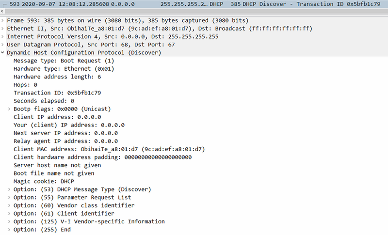

The phone would then proceed with sending a => DHCP Discover <=
000032.166|dhcpc|3|00|dhcListener: Read succeeds: eth0 state: PREINIT
Listening on LPF/eth0/00:04:f2:ac:89:bb
Sending on   LPF/eth0/00:04:f2:ac:89:bb
Sending on   Socket/fallback
DHCPDISCOVER on eth0 to 255.255.255.255 port 67 interval 8

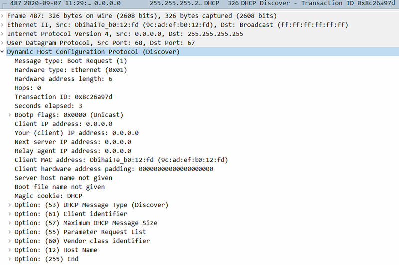

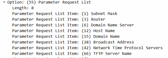

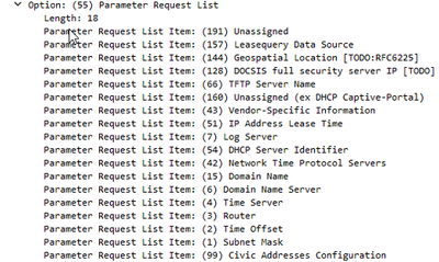

Within this DHCP Discover message, the phone uses various Sub-Options
  • Option 12 Host Name
    The above can be used to identify the Phone in the Network
    <test device.set="1" device.hostname="replace_with_own_value" device.hostname.set="1" />

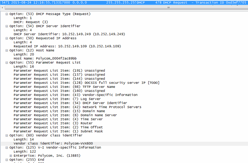

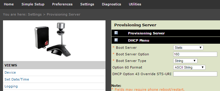

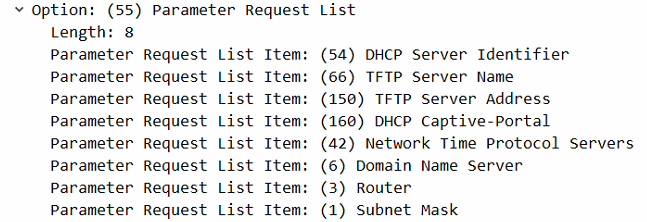

  • Option 55 is actually a List of Sub Options
  • 191, 157, 144 and 128 can be used for => DHCP VLAN discovery <=

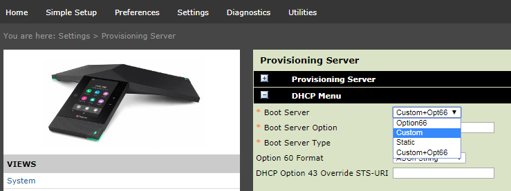

  • 66 or 160 (or 161 on phones using => Microsoft SKU <=) is used to discover the => Provisioning Server <= address. This could be a Real Presence Resource Manager as an example (http://<FQDN or Ip Address>/phoneservice/configfiles/)
    160 aka Custom (Skype 161) is queried first and the phone then tries 66 instead
    The order of this can be changed and is explained within this menu.
    Option66 Just use DHCP Option 66
    Custom Just use the DHCP Option matching the relevant hardware aka 160 or 161
    Static Ignore any DHCP options and use the Provisioning server manually added
    Custom+Opt66 Use the relevant Hardware Option aka 160 or 161 and if no option fall back to Option 66
    The Boot Server Option can be used to manually change from 160 (161 Skype Sku) to any other free option.
  • The Option 43 utilized during the initial boot-up has no relation to the Option 43 required for a Pin & Extension setup in a => Skype for Business environment <=
    More details on the Poly DHCP Vendor Option can be found in the => Technical Bulletin 54041 <= and troubleshooting => here <=
    The Skype for Business Option 43 is described below in more detail
  • 7 is the location of a => Sylog Server <=
  • 54 is the DHCP server name so multiple replies from different DHCP Servers can be identified in the DHCPOFFER and DHCPREQUEST messages

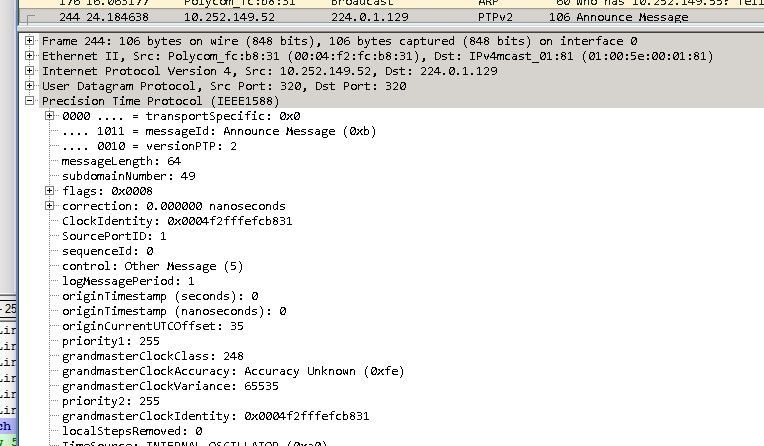

  • 42 like 4 can be used to set the => time <= on the phone
  • 15 can be used so the phone can identify the Domain it is using
  • 6 is to identify the DNS / Domain Name server(s)
  • 4 like 42 can be used to set the => time <= on the phone
  • 3 requests the default => gateway address <=
  • 2 defines the time offset the Phone time is using to determine the correct region in the => timezone <= the phone is based
  • 1 request's the phones => subnet address <=

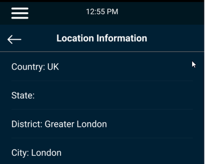

  • 99 is the Civic Addresses Configuration based on RFC4676 >here< GEOCONF_CIVIC 99
  • Option 60 Identifies the Vendor Class Identifier
    The vendor class utilized during the initial boot up has no relation to the Option 43 required for a Pin & Extension setup in a => Skype for Business environment <=
  • Option 125 contains multiple sub-options with specific information about the Phones

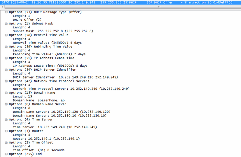

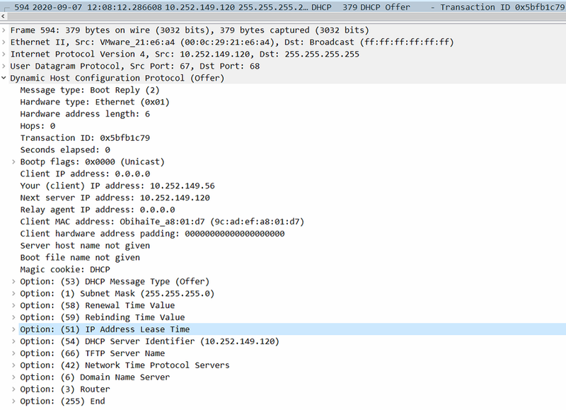

The phone can then receive one or multiple DHCP Offers:
NOTE: The Offer does not mandatorily need to contain all requested options!
DHCPOFFER from 10.252.149.249

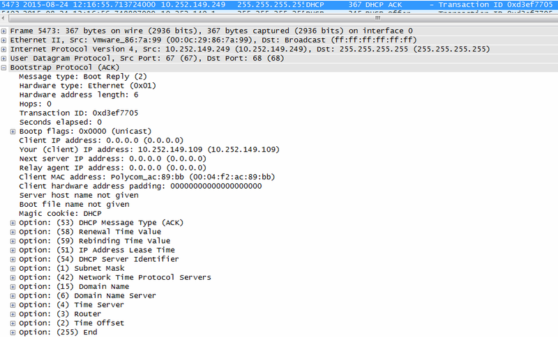

The Phone would then Request the IP Address and everything else:
DHCPREQUEST on eth0 to 255.255.255.255 port 67
And the Server would ACKNOWLEDGE this exchange
DHCPACK from 10.252.149.249
The Details can be seen in the Phone logs:
000033.490|dhcpc|3|00|dhcListener: Read succeeds: eth0 ip: 10.252.149.109.
000033.493|dhcpc|3|00|dhcListener: Read succeeds: eth0 option: subnet-mask 255.255.252.0.
000033.494|dhcpc|3|00|dhcListener: Read succeeds: eth0 option: routers 10.252.149.1.
000033.494|dhcpc|3|00|dhcListener: Read succeeds: eth0 option: domain-name-servers 10.252.149.120 10.252.130.10.
000033.495|dhcpc|3|00|dhcListener: Read succeeds: eth0 option: domain-name sbaierhome.lab.
000033.497|dhcpc|3|00|dhcListener: Read succeeds: eth0 option: time-offset 0.
000033.497|dhcpc|3|00|dhcListener: Read succeeds: eth0 option: dhcp-lease-time 691200.
000033.498|dhcpc|3|00|dhcListener: Read succeeds: eth0 option: dhcp-server-identifier 10.252.149.249.
000033.499|dhcpc|3|00|dhcListener: Read succeeds: eth0 option: ntp-servers 10.252.149.249.
000033.500|dhcpc|3|00|dhcListener: Read succeeds: eth0 option: time-servers 10.252.149.249.
000033.503|dhcpc|3|00|dhcListener: Read succeeds: eth0 option: broadcast-address 10.252.151.255.
000033.506|dhcpc|3|00|dhcListener: Read succeeds: eth0 option: dhcp-lease-time 691200.
000033.507|dhcpc|3|00|dhcListener: Read succeeds: eth0 option: dhcp-message-type 5.
000033.508|dhcpc|3|00|dhcListener: Read succeeds: eth0 option: dhcp-renewal-time 345600.
000033.509|dhcpc|3|00|dhcListener: Read succeeds: eth0 option: dhcp_rebinding_time 604800.
000033.532|dhcpc|3|00|dhcListener: Read succeeds: eth0 state: BOUND.

Option 55 in the DHCP Discover:

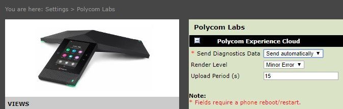

Poly Experience Cloud
The Poly Labs feature can be activated to send analytics automatically to Poly
The phone establishes a secure connection to the Poly PEC server

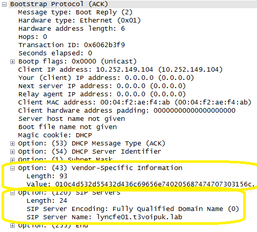

Troubleshooting Option 43 / 120 Issues.

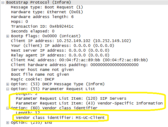

Taking a Wireshark trace during the Phone is booting up will show the DORA for discovery, offer, request, and acknowledgment (Source => here <=).
Current versions of UC Software already Identify themselves as a MS-UC-Client after booting up.
This happens after the initial DORA by sending a DHCP INFORM utilizing the Option: (60) Vendor class identifier.
This is being used to identify if the Option 43 is correctly setup so we can display the Extension & PIN sign in option.
The Option: (55) Parameter Request List requests Option 120 and Option 43.

The DHCP server will respond with an ACK and present the requested Options.
The Option: (43) Vendor-Specific Information will not be in a human readable format.
Using the Copy => Bytes => Printable Text Only feature of Wireshark the Data can be displayed when copied into a text editor.
+]MS-UC-Clienthttpslyncfe01.t3voipuk.lab443%/CertProv/CertProvisioningService.svcNAP
The DHCP Server would show these options like this:
Our Polycom Guru Jeff Schertz explains this in greater detail => here <=
Setting the Logging via the Web Interface (UCS 5.2.0 or later only !)
image image image
Or via a Configuration File:
<PIN log.level.change.tickt="1"
log.level.change.cfg="3"
log.render.level="0"
log.render.file.size="1000"/>

Manually configuring an Option 43 STS-URI:
In an environment where there is no Option 43/120 or an incorrect setup STS URI this can be provided manually via:
<test dhcp.option43.override.stsUri="Specify URL here" />
Correct Example:
dhcp.option43.override.stsUri="https://lyncfe01.t3voipuk.lab/CertProv/CertProvisioningService.svc"
Polycom Trio
After booting up the Polycom Trio will keep sending multicast packets from port 320 to port 320 for it's Precision Time Protocol

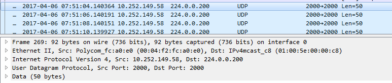

Polycom Visual+ or VisualPro
The RealPresence Visual+ sends out Multicast Traffic in order to advertise itself within the network to RealPresence Trio's
It uses an IP 224.0.0.200 and the port 2000 for this.
Once the Trio itself add's the Visual+ to connect the Trio will connect to the Visual+ and pair:
The Trio Logs show this Discovery package as:
1121134633|mr   |1|00|Discovery from 0004f2fd1851 10.252.149.54 port 8000 status 0 pair 0 hw 2:Trio Visual+
1121134634|mr   |1|00|Discovery from 00e0db48c130 10.252.149.55 port 18888 status 2 pair 0 hw 8:RealPresence Group 500
The following log:
log.level.change.mr="1"
or via the Web Interface shows this:

Booting up an ObiHai Software edition phone does not use LLDP or CDP and starts with the DORA DHCP Process:
The DHCP Discover:
    The above is the actual model number
  • Option 55 is a List of Sub Options
    42 can be used to set the time on the phone
    66 is being used to identify the TFTP server location. A OBI2182.xml (Depends on the actual model) file is being requested to provision the phone if any other provisioning via PDMS-SP or similar fails.
Once the DORA is complete the phone then starts a DNS query for root.pnn.obihai.com and connects to the server:

Unlike the "older" legacy ObiHai phones the new Poly D230 as an example will start with 3x LLDP packets and 3x CDP Packets:
It then starts with the DORA DHCP Process:
The DHCP Discover:
    66 is being used to identify the TFTP server location. A VVXD230.xml (Depends on the actual model) file is being requested to provision the phone if any other provisioning via PDMS-SP or similar fails.
    150 is being used as well for TFTP discovery
    160 is being used as well for TFTP discovery
Once the DORA is complete the phone then starts a DNS query for prov.obitalk.com and connects securely to the server:
The phone then starts a DNS query for root.pnn.obihai.com and connects to the server:
The phone then starts the TFTP request received via Option 55 Sub Option 66 if received prior for the device file name:

Use DHCP Option 99 to provide location details
Since UC Software 5.7.0 Poly Phones support the Civic Addresses Configuration based on RFC4676 >here< GEOCONF_CIVIC 99
The DHCP Discover requests option 99 via option 55 Parameter Request List
The DHCP Server then sends a DHCP Offer including any configured option 99

If the Phone has successfully received its Location it can be checked via Settings > Status > Location Information:

similar to DHCP LLDP can be used to provide the Location Identification to a Poly phone
LLDP is enabled by default and can be used as a method to gather Location-based information by the phone.
LLDP can provide either the location via the Location Identification and/or the > ELIN <(Emergency Location Identification Number)
Configuring the civic-location identifier as in the above example on a Cisco Switch:
location civic-location identifier 1
 city London
 country UK
 county "Greater London"
 primary-road-name "My Road Name"
 room "Upstairs Home Office"
 number 789
Configuring the elin-location identifier as in the above example on a Cisco Switch:
location elin-location 0123456789 identifier 1
Assign one or both to a network port:
interface FastEthernet0/8
 location civic-location-id 1
 location elin-location-id 1
The Phone will display the Location:
Utilizing the Location Manager logging, in addition, can help to troubleshoot this further via:
Settings > Logging > Global Settings > Global Log Level Limit > Log File Size (Kbytes) > VVX/SPIP/SSIP prior to 5.5.0 = 180
Settings > Logging > Global Settings > Global Log Level Limit > Log File Size (Kbytes) > Trio 8300 & VVX after 5.5.0 = 1000
Settings > Logging > Global Settings > Global Log Level Limit > Log File Size (Kbytes) > Trio or CCX 10240
Settings > Logging > Module Log Level Limits > Location Manager > Event 1
It will show the LLDP received Location:
0114130511|loc  |1|00|setCurrent: new current location is "My Road Name, Upstairs Home Office, 789  London,Greater London,  UK"
