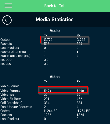

I registered 2x Poly Trio 8800 with Visual+ running the current UC Software 5.9.2
On both I setup up Hybrid/multiple lines.
Line 1 is an Asterisk test server running 11.25.1 and a Video call between two Trio's shows as:
As the above demonstrates the Asterisk server only allows a maximum of 540p for the Video which is not the highest quality the Trio is able to do.
NOTE: Poly cannot recommend any settings or changes to the Asterisk server and any support to follow up questions would need to go via the Digium community!
Using the People&Content Software via the USB cable or the Polycom Content App via the Network will only share within the room and not the far site. Again this is a restriction on the Asterisk end.

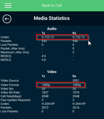

The 2nd unregistered line is configured so once it is selected (called other Trio) it will simply dial the IP address of the other Trio:
Once the call is established we will send and receive 1080 for the Video:
Using the People&Content Software via the USB cable or the Polycom Content App via the Network will share in the room and the far end:
The above is a very basic example and Zoom or BlueJeans or other services can be added. The Trio can also use the Passthrough software to offer its connected Camera and speaker/microphone to any PC application (Windows 10).
