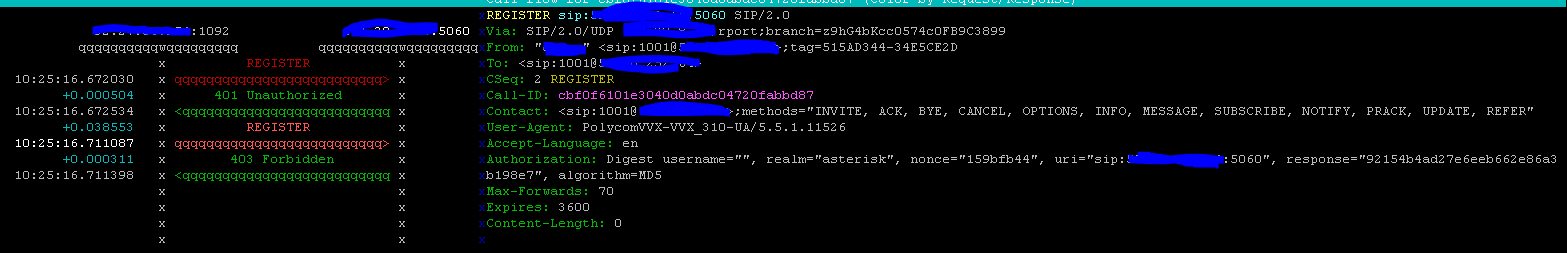

Hi,
Trying to register to an asterisk server and although I have set my extension in authentification > User ID looking at a trace its showing as Authorization: Digest username="" . How can I correct this?
Thanks
Polycom VVX310 5.5.1.11526

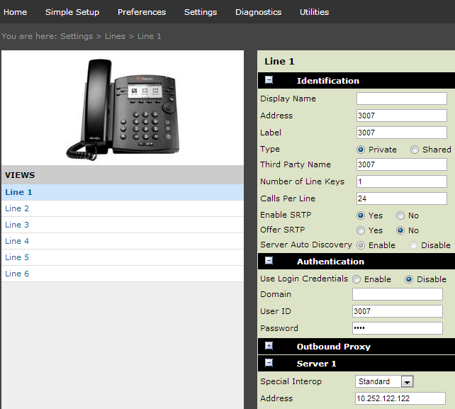

11-03-2017 05:11 AM
Hello voipkiller,
It is very difficult to try and help if you do not follow the instructions given.
From a User Credential view you require:
- Address = the Extension/DDI/Username assigned to the Phone’s Account on the SIP Switch
- Auth User ID = the Extension/DDI/Username assigned to the Phone’s Account on the SIP Switch
- Auth Password = the Password assigned to the Phone’s Account on the SIP Switch
Not populating the address field most likely causes your issue.

11-03-2017 05:41 AM
Hello voipkiller,
Unfortunately your original replied picture did not show this so all we can do is assume. In addition you still have not posted a backup of your configuration either.
From my perspective the next step I can recommend is to upgrade to a currently supported version like UC Software 5.6.0 or UC Software 5.5.3 instead.
