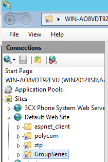

  • image Assign the Virtual Directory to a local Directory
  • image
    Unzip the Group Series update but point the "root" Directory to the Directory containing the unzipped files.

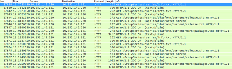

  • Expand the default Web Site and select the Mime Types
    Ensure you have the .plcm , .txt and .sig allowed
  • If you are updating to a major or minor release, obtain a software update key code (.txt) file from the Polycom website. Save the file as sw_keys.txt and place it in rseries/platform/ on your web server.

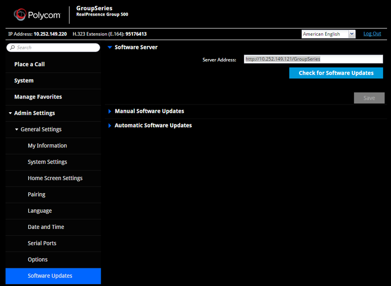

  • Upgrade Server should include the Protocol
  • image
