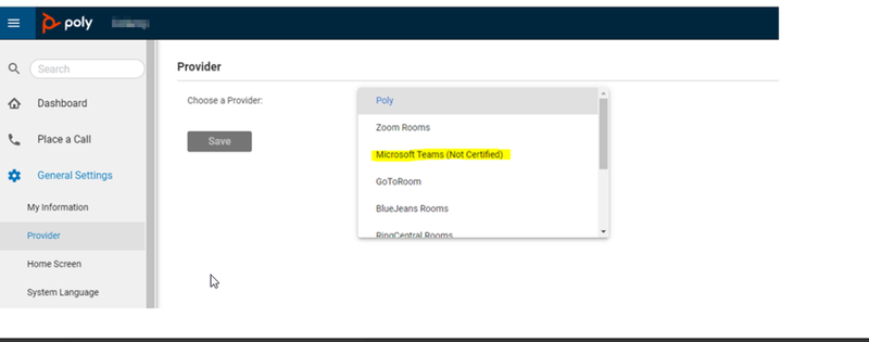

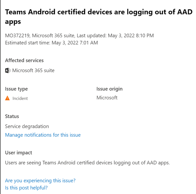

Our G7500 have been working in Teams Room mode for many months without issue, then suddenly the feature no longer works. Also our X50 and X30 can no longer work in Teams Room mode either. We now have no Poly units able to run in Teams Room mode accross our business. No recent firmware or software updates are applied but the units are all on latest firmware. Please confirm that Poly X50 and X30 are currently Certified devices and Teams Room compatible?
Thanks,
Hello @Sneaky_AU
just because a G7500 used to work with Teams it does not make the device a certified device for Microsoft Teams. Our Partner Microsoft simply has not yet certified the G7500 as a Teams Room device.
We recently, to outline this simple fact, added (Not certified) to the Provider for customers to understand this. If a customer still chooses to run the G7500 in this Provider mode it is at their own risk.
The G7500 was never certified by Microsoft to be used with Teams. It is only for proof of concepts or lab testing and Microsoft Teams with a G7500 must not be used in a production environment until our partner Microsoft certifies the unit.
Our Partner Microsoft could "block" the G7500 at any moment with no notice so the customers must understand the risk of using this configuration.
In regards to Studio X no longer being able to sign in to Microsoft Teams and/or having been signed out over the weekend this is a known issue affecting most Android devices.
This is not a Poly Issue and affects other manufacturers.
Microsoft states this in the Teams Admin Center as MO372219 or TM371762 but in order to see this, you have to be a tenant admin. In M365 admin center you go to Health and then Service health
Public Info for example: https://twitter.com/MattEllisUC/status/1521568533964066817
