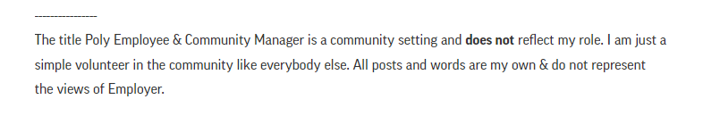

Hello @MatthiasW
EDIT: For some weird reason the picture shared does not display so this same as text from my signature:
The title Poly Employee & Community Manager is a community setting and does not reflect my role. I am just a simple volunteer in the community like everybody else. All posts and words are my own & do not represent the views of Employer.
I believe the above states that I am just a volunteer.
